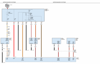

Here is a diagram for a 2018. Should be the same...

Thanks for the diagram!!! This will be very helpful. Gonna go pin it out and see where I’m loosing the power. My guess is the bcm. Also gonna hook up my scan tool later and see if I’m getting any codes from it.
