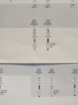

Can someone confirm the right rear colors? One example shows what I stated above, but beside it in another drawing the colors are reversed order....

Your colours are correct

Damien....so The original post is correct? For some reason the dealer diagram reverses the colors on the LEFT REAR (not right sorry). That's why I was confused. So...to confirm....Gray/lg is positive and Gray/dg is negative?

According to my wire diagram for the truck, your first post is correct. It's also the one I used to hook up my line out converter.

Can confirm with Damion that on alldata for my truck (2014, base system) your 1st post is correct wiring.

From this picture, you can see my confusion for the left rear. Glad we got that straightened out!

Pins usually go in sequence as well so you could use common sense too. For ex. All positives at the top of the plug, while the negatives are the bottom. Or the plug goes in order across: +,-,+,-, etc. With three other speakers, you should be able to find the sequence.

Agreed...very misleading. Did the dealer give you these at the same time? Why is the "shading" for the plug different between the two? Almost looks like they gave you two configurations?

Yes, the dealer-connect printed the entire thing for me. The "shading" goes into a "shaded box" with the words EXCEPT STANDARD CAB. Again, its only different for the left rear. leads me to believe its a type.
