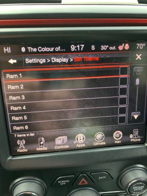

Uploaded are the screen shots! Thank you for replying. I did try every theme I could find under settings and it just changes the "hue" under the icons

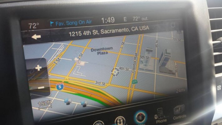

The settings you showed were for the Screen themes. You actually have 7 of them. You also have a setting for your Map themes that is located in your navigation settings. Push the view map icon. When the map comes up push the settings menu that shows up on that screen. It will show settings on that screen that you can navigate to too change the Map theme. There are five different ones but they are listed by name and not by number. They have Ram, Fiat,Chrysler, ect. I keep mine on Fiat because I like the blue background color. I don't have pictures of the screen that you go to the select the different map themes but when I get in my truck later I will take step by step pictures for you if you haven't been able to find it yet. This is a picture I had of the map screen set to Fiat. 4dd1221e3f566ea791c2d3e4ba232992.jpg

Ok here is how you change the map themes if you haven't already tried. Go into the navigation screen. Go into map setup. Then go into map appearance. Once you press map appearance these five options should come up for you to select.

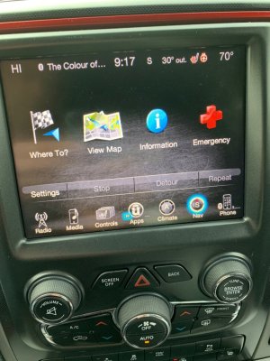

Thanks for your reply. There was an update on the software that I just completed. Maybe when you are just looking at navigation it should be this gray? I thought it would be more in 3D.. I have 3D checked and I also tried the 2D mode. Enclosed are two other pictures.
