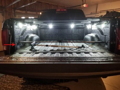

might as well update the thread after the Bilstein install. Bils set to 2.8. I got 3" lift in the front end. Next up are rear coil spacers to get just a little rake back in. I also did bed lights, so there's a picture of those too. I just bought some cheap flat pucks off amazon and ran wires off the battery to an in-line fuse. They are switched at the back of the truck, in the bed. I just enlarged the factory hole in front of the tie-down and fed wires thru that. the red arrow shows where the switch is tucked in.

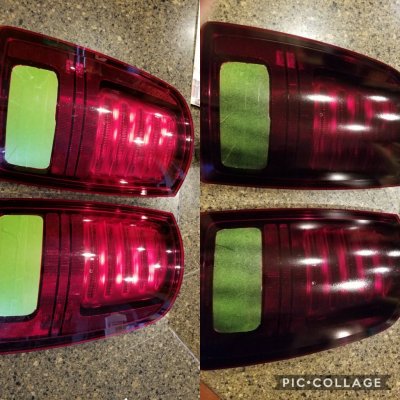

my tint project. I still have to sand down the clear and polish them out. Before on the left, after 4 coats of VHT Nite shade on the right.

They came out with more of a pebble finish than I planned 20180219_141328.jpg

Did you spray clear over them?

Goose, 4 layers of clear, using Dupli-color perfect match.
