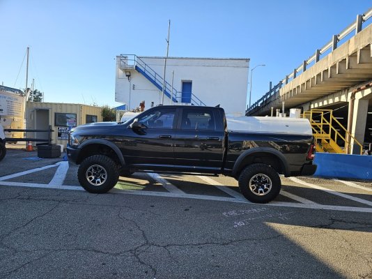

Hey guys first post here. I have a 2016 rebel with a bds 6" lift (deleted air ride) I am running stock wheels with 2" spacers and 35" tires.
Looking for wheel sizes in 20" that would give me a similar fitment, if not a little more fender poke.
Thanks for any help!

Nice looking setup!
Just get the specs on the current factory wheels, factor in the 2” spacer, and get wheels with those similar specs. Not sure what the factory wheels are, but i would think a 20x9 wheel with a positive offset (like maybe +18 or so) would be close.
Personally, i love the look you have going now! Dont really care for spacers though.

It looks as though your stock wheels are 17x8 with a +25.4mm offset. So, with 2” spacers on there they are essentially now a -25.4 offset. So, i think 20x8 wheels with a -25ish offset would get you close to the same stance.

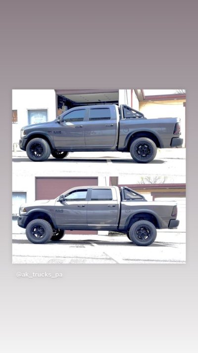

20x10-18 with give you the stance you’re looking for.

This is your truck, air suspension top 6” lift bottom with a 35” tire and a 20” wheel.

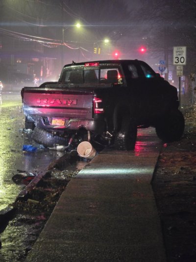

Truck totaled while parked. High speed police chase :(
