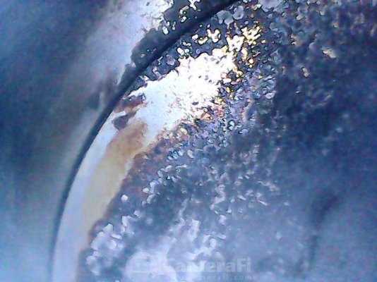

Yeah, could be clogged and not atomizing, worth a try running redline si-1 though, I say that one seams to be effective, amsoil pi, rp treatments, techron all have PEA which is the best known injector cleaner. It is a specialized detergent. Nothing to loose but a couple bucks, much to gain. We had a ram forum member boroscope his combustion chamber after running si-1. This was just after one treatment I believe, he had before and after pics, you can see it melting away baked on carbon on piston top. It would be cool if this solved it.
Redline si-1 also has esters so those also clean..
