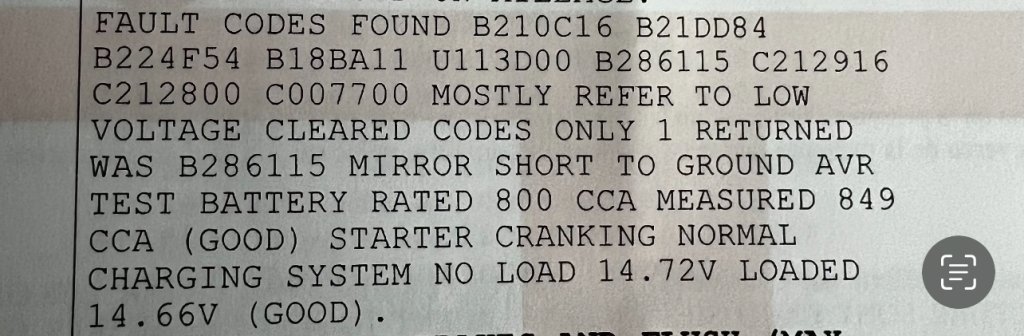

I recently noticed that my battery gauge was fluctuating quite a bit so I went and had the codes scanned.
Every thing cleared except for one code- B286115.
Has anyone else had this happen to them before? It says that it’s a mirror short to ground. Whenever I hit my switches for my windows the battery gauge changes quite a bit and even in park goes back and forth. Alternator is perfectly fine.
Thank you!

Did you ever sort this? My truck popped up with the exact same thing this morning
