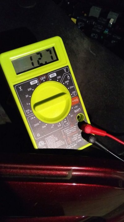

@BigHornRam17 , I was concerned once as well after fiddling with some of my internal power charger outlet fuses that killed my old battery, and after replacing the battery decided to do a parasitic draw test as @Dean2 recommends. I followed Brian Laskowski's (FordTechMakuloco) advice on doing the test. I bought a cheap multimeter from Walmart, and it was good enough. It didn't have memory and the other spiffy functions a fancy Fluke meter does, but you can just sit there and stare at your Walmart meter for 15 minutes like I did. A beer helps.
