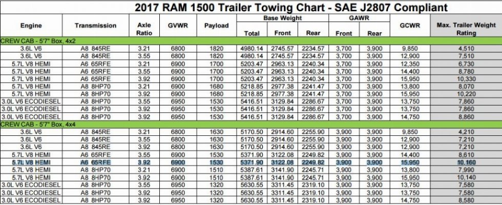

Good Morning gang,
I am looking to tow this here:
and here is the highlighted specs on my ram:
From what I can understand, I'm within my weights if the dry weight is correct. I will be exhausting every measure to ensure I'm not at the GVWR. That includes removing all water and waste water, extra items not from the manufacturer, and food/supplies. I will most likely be the only one in the vehicle at the time and a full tank of gas.
I'm only travelling 45km or about 28mi one way. The tires on the vehicle are a load range E 10 ply MT tire.
Can I pull this off?

If you're keeping it and the truck empty, and have a proper hitch, sure.

Yeah that's 1000 lbs on the hitch dry and empty that only leaves you 500lbs for people and supply's in the truck it's pretty close.

One time 28 mile tow? If you are the only other weight in the truck that should be fine. The 1500 has plenty of power and the trans does good. The biggest issue with any 1500 is less stability. 28 miles is not bad at all though.

I personally think that's way too much trailer for a half ton. Don't go by dry weight. If you want some safety margin, use the gvwr figure. If we use 10k as your loaded trailer weight, at 12% tongue weight, that's. 1200lbs, your payload rating on the yellow sticker is probably 1400 or so lbs, so if your 200 lbs, your maxed out before you put a single campfire log or any gear in the truck or trailer.
A 33 foot rig of those weights is a big trailer. I think your in 3/4 ton truck territory. Good luck

I totally agree, it comes down to not being able to afford a "real truck" I'm gonna have to make due with what I have. I understand the GVWR and with that number it would be too heavy. With that being said I will ensure everything extra is removed. As soon as I load it I will determine if I want to tow it or not. If I don't feel comfortable, I will get a "real truck" to do the job.
