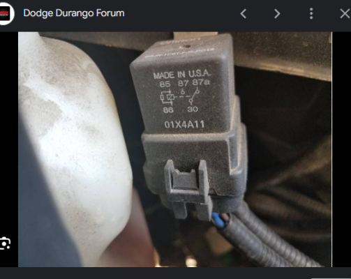

I don't remember which years were covered, but both my 13 Ram and the wife's 11 Durango had the recall.
Originally, the vehicle had the fuel pump relay hard soldered to into the TIPM, so if the relay died the entire TIPM had to be replaced.
The recall involved the dealer snipping the relay wires in the harness under the TIPM, then wiring in a separate fuel pump relay.
I just had a thought that if your truck had this recall done, the relay in the TIPM would be dead anyway and the remote relay would be the one that powers the fuel pump.
The add-on relay looks something like this and is attached to the side of the TIPM:

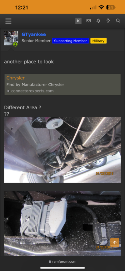

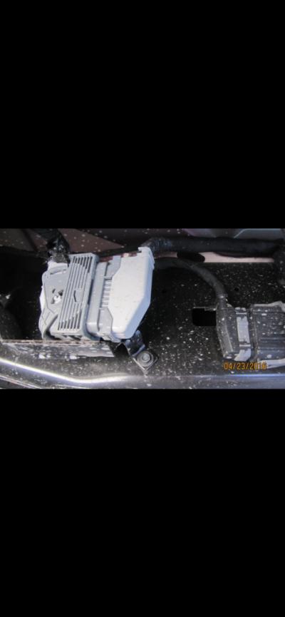

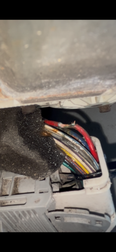

Well I found the issue. Oddly enough, @GTyankee posted a pic of the problem area back in May of 2022 and there was even a comment made about hoping the fuel pump wiring wasn’t in there…it is! The first two pics are from that post, the third pic is my truck/issue.
There was a thin layer of black tape/felt protecting the wires where they entered the upper side of the connector, but over time it has shifted down the wires allowing them to rub against the body until a couple wore through.
I’m now trying to figure out which connector this is so I can determine what the RED wire that shorted with the 12v fuel pump feed (DRK BLU/ORG) is. Anyone have any idea what the connector is called on this site (https://connectorrepairkit.mopar.com/) so I can look it up?
