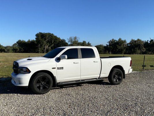

2017 1500 Sport Night
Picked up my 2017 1500 sport night edition from carvana this week with 15k miles
- crew cab
- 6.4 foot bed
- 3.92 axle ratio
- 4x4
- leather interior
- black projector headlights
I have some plans for her to make it more fun for me to drive. This will be my daily driver and as of right now I need to be able to fit in 7' parking garages which limits what I am able to do as far as lifting.
Currently my plans are:
- 35x12.5 r17 toyo or nitto r/t
- 17x9 wheels with -12mm offset
- bilstein 5100 all around with eibach springs in all 4 corners
- zone UCAs
- wulf 1/2" suspension spacers for the lean
- carli panhard drop bracket
- suspension maxx front sway bar links
- possibly a zone 1.5" body lift but Ill see how I like just the suspension lift first

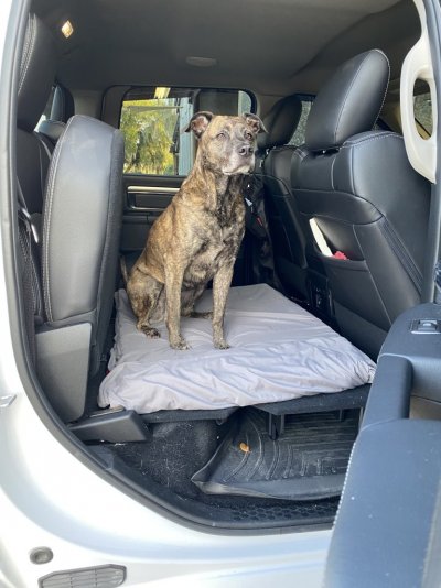

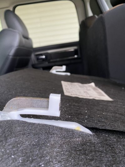

Did the folding rear seat mod by cutting the tabs that hold the seat up rather than putting washers underneath the seat.
I went this route because I want to use my fold flat floor and I was worried that putting washers under the seat would make it not sit right.
As you can see from the second pic, when the seat back is up and the seat is down, there is still plenty of metal catching on the hook at the back of the cab so the seat won’t flip forward on a passenger

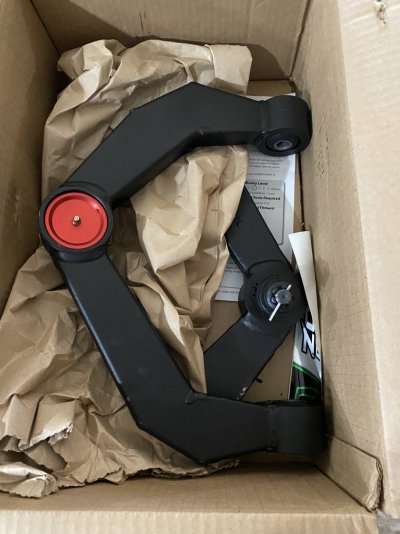

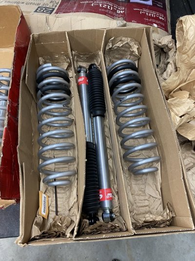

Santa came a few days early for me!
Delivered my:
- Zone UCAs
- Zone 1.5' BL
- Eibach Pro Truck Lift Kit
- KYB new top strut mount hardware

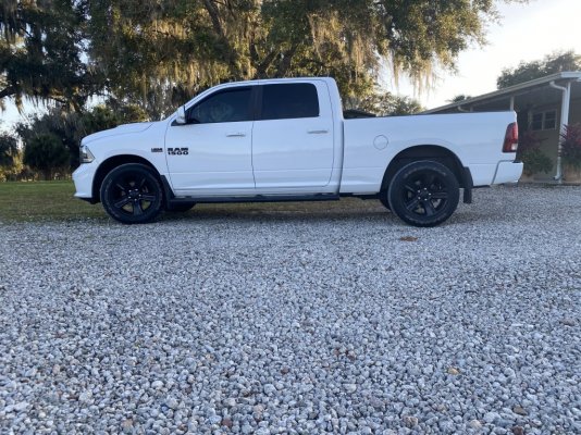

Dropped Wanda off today to have the Eibach pro lift installed. Snap rings at 2nd slot, RC 1/2" top spacers, new KYB top hats and Zone UCAs. Holding off on the body lift for now to see how I like the truck with just the eibach on it.
Ordered 315/70r17 cooper S/t maxx and procomp 32 bandido wheels in 17x9 with -6mm offset today and hopefully they will be delivered and installed by saturday.
Ill add pics when I pick the truck up!

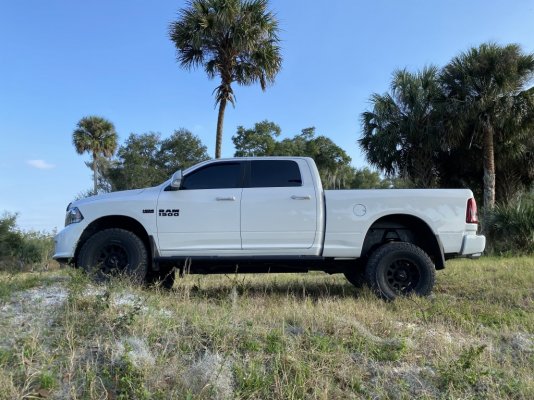

Here is the truck with the eibach pro kit installed and 2nd ring, RC 1/2" top plate spacer and zone UCAs on stock 20s still.
Front before height: ~36"
Rear before height: ~40"
Front After height: ~ 39.5"
Rear after height: ~41.5"
Both sets of measurements at 1/2 tank gas
Havent driven too much yet but the ride seems a lot better but I can definitely feel a little bit more sway since i havent added the longer extensions yet.
Right now it sits just about as tall as a stock new generation f250.

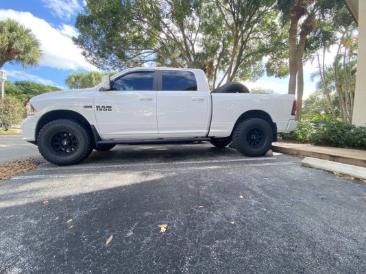

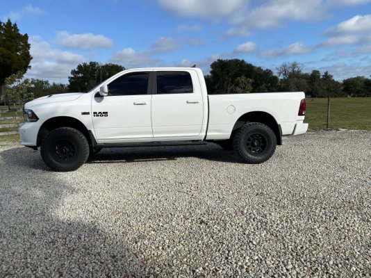

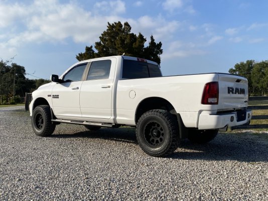

Lift is finally "done"
- Eibach pro truck lift with rings at 2nd slot
- RC 1/2" top plate spacers in the front
- Zone UCAs
- 315/70r17 cooper discoverer st maxx
- 17x9 procomp 32 wheels with -6mm offset
- lug nuts and 77.8 to 108 mm hub centric rings
I have a zone 1.5" body lift I may still be installing at some point when I can get a long weekend I dont need to drive since this is my only vehicle
After the lift was installed I was on stock tires for about a week and fender measurements on stock tires were ~36/40 inches F/R before and 39.5/41.5 F/R after. Havent measured with new tires on yet
Note- front wheel is slightly turned from backing in so it may look "off" in the pics

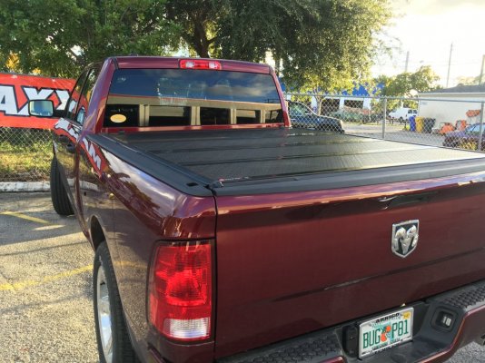

crazykid1994
Sep 21, 2013
5,063
5,064
Florida
I had a quad fold from bakflip. Fibermax. I’ll never buy the fibermax again. 3years and trashed. Should have bought the mx4 from them instead which is aluminum. Have a hard roll up now which I actually like better because when all the way open I can still see out my rear window. Nice thing about the bakflip was the bakbox that I bought for it. I was going to buy another bakflip cover so I could use the bakbox with the new cover but liked the style of the truxedo hard roll up over the bakflip hard roll up because it velcros on the sides instead of just a rubber gasket.
Would you say that the hard rollup cover is worth the $500-700 more than a soft roll up cover?
crazykid1994
Sep 21, 2013
5,063
5,064
Florida
I would say it depends on your needs. I bought the hard roll up for extra protection. I tend to keep tools and other valuables in the bed so for me it was worth it. If you are just tossing stuff in the bed for a quick trip and need it to stay dry and don’t leave stuff in the bed it may not be as worth it.

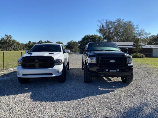

And next to my brothers 2007 F250 6.0 powerstroke leveled with readylift spring spacer + fox shocks all around and 35x12.5 R20 ridge grapplers on -18mm wheels
