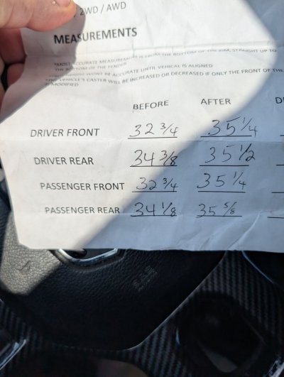

I have some measurements written down on a paper in my truck. They measure from the bottom of the rim to the fender, not from the ground, so it should eliminate the tire size aspect of it. I'll post the numbers in the morning after I'm done work.

The before numbers are bone stock on a 2019 classic big horn, standard ride height with 275/60r20. Measuring from the bottom of the wheel, not from the ground. So, going from the bottom of the wheel, pass the center of the hub and up to the fender. This should take out any difference from tire size or air pressure.

Thank you. Un loaded im at 29 in Front 34 in the back stock rims lt265/70R17
