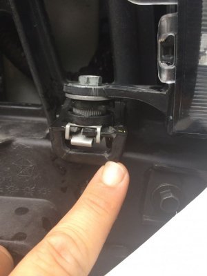

Unfortunately I’m having some difficulty and hoping some of the members would be able to help me out. I’m replacing my right side headlamp mount. The previous owner must have hit something and broke the lower tab on my headlight. The lower bolt and nut is completely broken from my truck. I’m looking to see if anyone knows what the oem numbers for the bolt and nut system is. These are the pieces I’m referring to. Any help is appreciated

Is the bolt and the metal nut/clip completely free? Does the bolt just spin and not move?

Thank you @crash68. The whole tab was broken off the headlight. I ordered a new headlamp mount. I’m looking for the full assembly of the bolt, spacer and nut. They’re missing from my headlight. That picture was taken off google

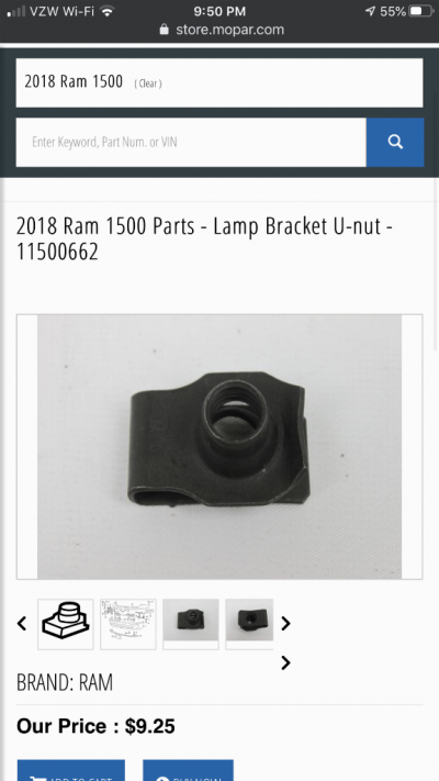

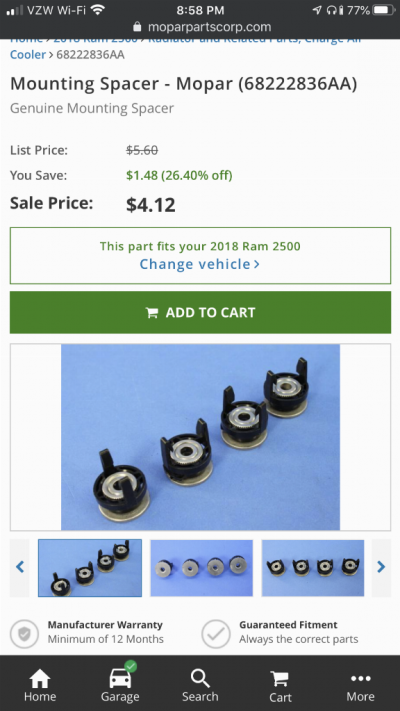

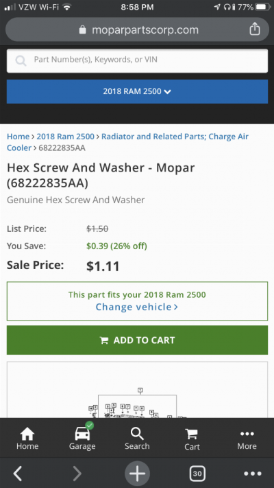

This proved to be more difficult than I thought. I've found 2 out of the 3 pieces you need. I can't seem to find the clip with the threaded opening that the bolt goes into

This maybe the other part.
It's all Mopar parts not whatever site I mentioned.
