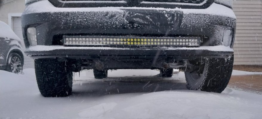

So, this truck has good bones and the engine purrs but it's been an enigma since I bought it a month ago. So far I've replaced both front wheel well liners (they were hacked to pieces), the radiator cover (which was completely missing) and cleaned and fluid filmed the undercarriage, doors, etc.
While replacing the wheel liners I spotted a couple of brackets behind the front bumper, just hanging there. So I've done some research and discovered there should be an air dam there.
Could someone please point me to the correct part and a supplier that you trust? I bought the wheel liners at two different times from two different suppliers. The driver's fit like a glove but the passenger's wasn't even close and took me all day to modify. pulling it out, marking it, and putting it back in several times.

I believe the air dam is just held on with push pins that go straight up. Those mounts you circled in the photo are for other things. I think the square ones are for a plow mount. I don't know your year, but check this which looks like 2009-2024 and has the diagram of where it goes:

Sorry fellas, the year and model were in the post title, 2017 quad cab sport. I did discover that those rectangular mounts were for either a plow or the tow hooks but the flimsy plastic horizontal bars (with the rusty clips) still have me perplexed. I don't think they are for the air dam. And from my research, it appears that the 2017 has mostly push pins but with one or two 10mm bolts on each side.

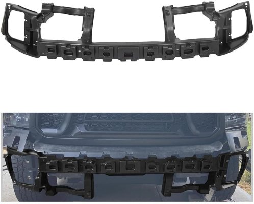

In all the videos I've watched about removing or replacing the air dam, I've not seen these weird brackets (highlighted in yellow). I'll try to get better pics later this week. They are very flimsy and easily can be rocked by hand. There's one on each side.

Update: after watching several videos and getting under the truck again, those brackets are part of the "front bumper energy absorber" and the part highlighted above bolts to the bottom valance (air dam). My understanding is that this is somewhat particular to the Sport model.
