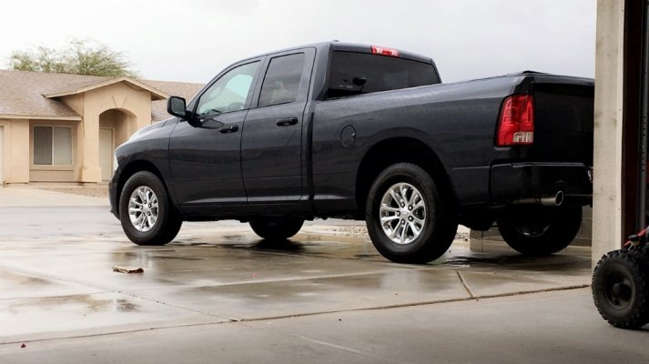

I recently removed the Hemi badge and I’m extremely pleased with the look.
