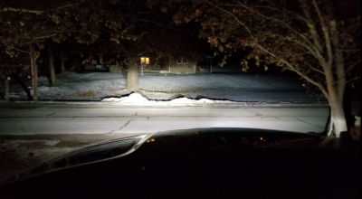

Best bang for your buck is a true retrofit and swapping out the stock projector for a true HID projector since the stock ones are frosted and designed for use with halogen bulbs. That being said your brightest option other than that would be dumping in a HID kit into the stock projectors. You can put LED's in your highbeams check out the Morimoto 2.0 2strokes that just came out there a tight squeeze but they do fit and that is what I run. I just finished up doing a retro fit on my 2500 projectors as well this is the passenger low/high projector HID with the 2stroke 2.0 in the highbeam. (No drivers side in photo wasnt finished yet).
