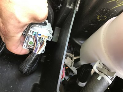

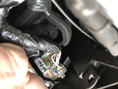

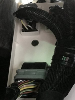

A70CFF97-7B46-4F51-9173-8C3FABC01A3E.jpeg DFD4ABE0-0ACC-4857-A35E-ABBDFBD9C569.jpeg 52A4E952-6EA2-4DCD-9274-A436BA36F4A5.jpeg Hoping for some help, looking to add remote start to my 2018 2500 6.7
Looked at the thread about 2017s but I’m not great with wiring so I’m hoping someone can tell me what I’m looking at.
Here’s front and back of underhood connectors as well as connector by the brake pedal, looks like everything’s there? Should just need a hood latch and programming if I’m reading things right.
Thanks for your help!!

View attachment 170278 View attachment 170279 View attachment 170277 Hoping for some help, looking to add remote start to my 2018 2500 6.7
On the 2017-18 you technically only have to ground pin 11 on the bcm (I'll have to look to see on which connector), buy new key Fob skins for your current fobs because they are already have the same board as fobs with remote start on them just need the contact on the skin, and use alphaobd to enable remote start.

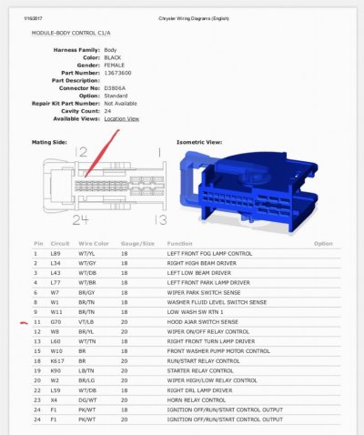

Can someone tell me where to find this pin 11?
Under your dash in a very fun and accessible area you'll see this. On the door side above the emergency brake. You'll want C1. Circled in Red
Then in that connector you want pin 11
2018 2500 6.4L Tradesman
Thank you, that is the pin I need to ground to bypass the hood latch to trick the bcm into thinking the hood is closed correct?
