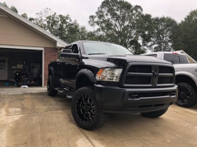

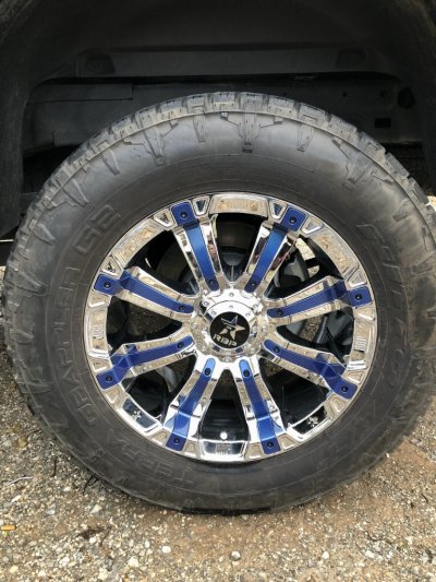

Are you gonna keep the stock rims? I’m running 35-12.5/20 aftermarket rims thought.
I recommend 35-12.5 Nitto Terra Grappler G2’s mine have 25K miles and still look brand new. Quiet smooth ride 10 ply(E rated)

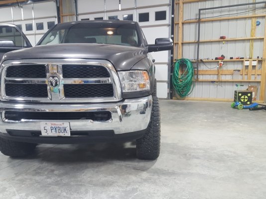

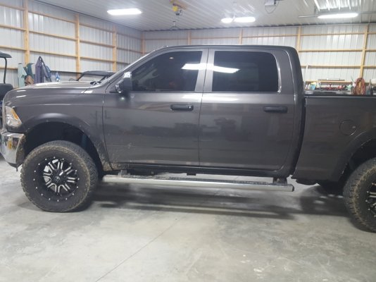

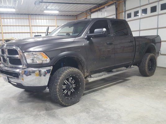

Nice Booner21, have you any pictures?
You will have to disregard the dirty truck it doesn't get washed during hunting season and isn't exactly a pavement princess.[emoji16]7bb0298e43c76e7db8b7485fd8c0c7a7.jpg08be0e6b254e21e7ef4822b0a664f6b8.jpg4bf6bfe95bf37027e8d650b87fd85070.jpg

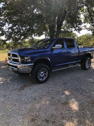

Mickey Thompson ATZ 35/12.50/20
I’ve gotten 50+k miles out of my first set just bought another for my new 18EC87A251-1404-42A7-859B-63539B19B19B.jpeg63ABAB15-B175-4691-8D80-2DE20BF58545.jpeg
