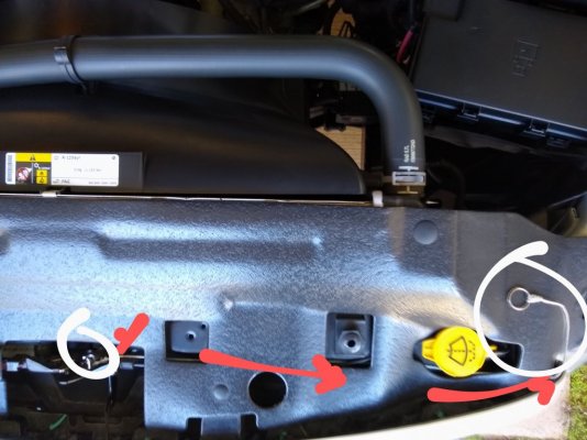

I resolved the possibility of it happing again by tying a piece of nylon string to the hood latch and routing it over to the drivers side headlight with a small metal key ring attached to it where I'd be able to fetch it out with a small telescoping magnet with the hood closed ... if it should happen again.
I have this simple set-up done on my current 2017 RAM just in case ... you never know.

Well, I guess I could post a pic of how I attached the nylon string with the metal key ring ... the nylon string is tied to the locking catch and routed towards the drivers side headlight and arranged where it's easy to retrieve with the small telescoping magnet with the hood closed.
When the hood is closed I can fetch the metal key ring with a small telescoping magnet and pull the key ring and the hood pops open ...
