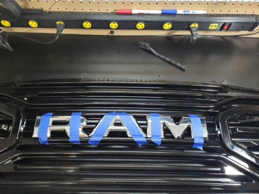

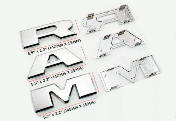

Received the chrome version of the 2019 RAM letters like the black ones Load97 linked in the OP. . .
No go.

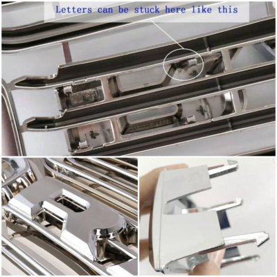

I can't see any conceivable way to attach them with the 3M tape. I was under the impression the tabs were a close enough fit between the horizontal slats to work with the tape. I'm must be overlooking something.
@load97
Did you use chrome letters on your black grill?
Are yours the same dimensions as mine? See below...

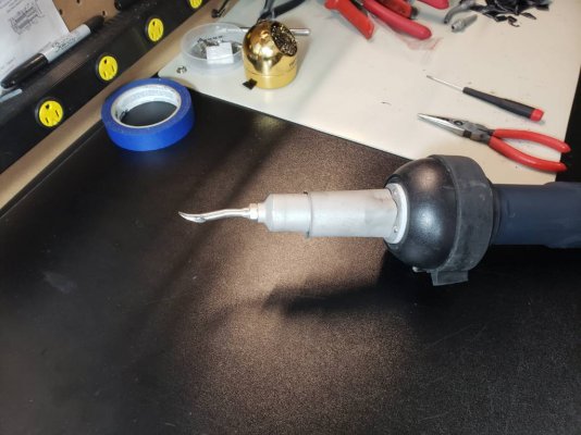

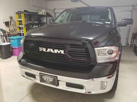

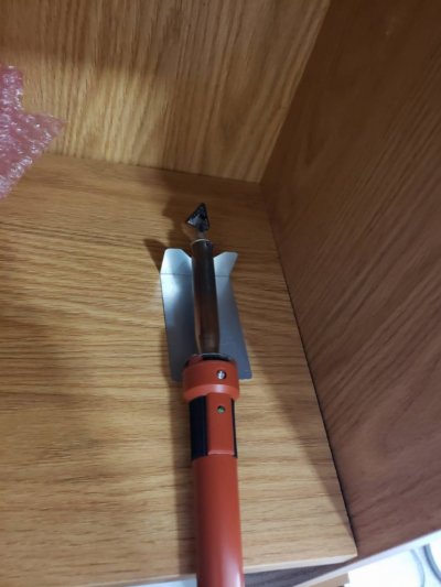

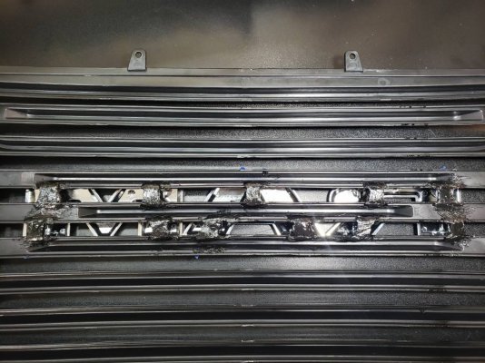

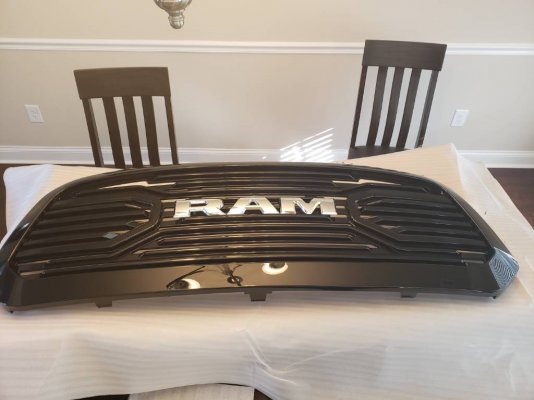

Ended up buying the larger 2017-2018 limited RAM letters along with an 80w plastic welding iron (get the warranty) and 1300w hot air welder from harbor freight.
Cut up some old abs plastic bezels for material/welding rods and made a framework from the back of the grill to attach them. It was a mess and not recommended. Maybe it's easier with better equipment. Chrome finish on the back of the letters impedes the plastic welding and should be removed if possible.

Ended up buying the larger 2017-2018 limited RAM letters along with an 80w plastic welding iron and 1600w hot air welder from harbor freight (get the warranty).
Cut up some old abs plastic bezels for material/welding rods and made a framework from the back of the grill to attach them. It was a mess and not recommended. Maybe it's easier with better equipment. Chrome finish on the back of the letters impedes the plastic welding and should be removed if possible.42b83cae2e66cf9d89fa633ccf899c8b.jpgd3b94793c9ee3bf26dcbd8d03ab4db03.jpg1d6b580c871d8cd691098b042f6b4b78.jpg63e2baa1a733ccffec8e395047527710.jpgb37b83e33d5eb58a55027f4c494f5fee.jpg53131fc72071705a4fe5052a862f76ad.jpg70fa4bed34efcad609d8246b0404895d.jpga129bc5c726bd381b4a275e407a9b806.jpg

That looks really good.
I’m planning on staying the chrome black route. How does the grill match up with the Crystal black paint?

It's very tough to tell it's gloss black vs the crystal/brilliant black like the rest of the truck.
Edit: in bright sunlight you can tell it's you stare at it long enough.
If anyone wants the smaller 2019 DT style chrome Ram letters I didn't use let me know.
As purchased & latest pictures attached...577adf5990e71228f48785b906d97094.jpg

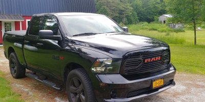

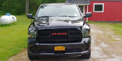

Need to put some spacers in and paint letters, but close to the finished product. Easy install if 0702191912_HDR.jpg anyone wants to do it. 0702191914_HDR.jpg

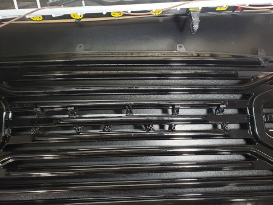

I’m trying to find the letter spacers somewhere.
The picture below is an actual 2019 grill from a guy near me.
Looks like the letters slide right into the openings on the spacers for easier attachment of the letters.
Aren't they molded into the grill? I ended up plastic welding letters into the grill I bought. (See previous posts above)
If you find a way to get the letter mounts/spacers let us know.
