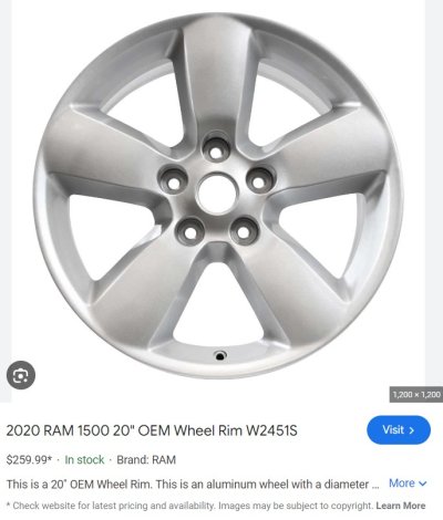

Yes. They are the factory 20" wheels from RAM. Similar to what's in the picture

They are not the sport wheels so you are limited to an 11.5" wide tire. You can fit a 35" tire easy
