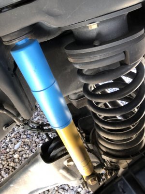

mine is the same year. the yellow and blue Bilsteins are factory with the off road package mine has it. they suck get some better shocks. i like my fox. and not autozone crap. your milage is right. empty i get 13 to 14 towing my 10.000 pound rv i get 7 to 8 less in the hills.

The yellow and blue shocks are Bilstein 4500's. They may have come off a Power Wagon. They are extremely stiff. I changed mine out for 5100's and the ride improved a lot.

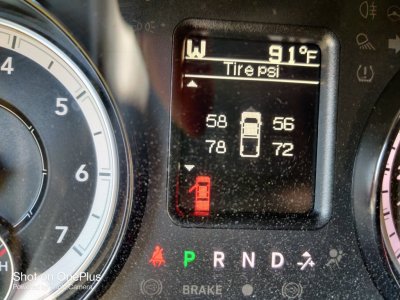

What air pressure are the tires at? If they're at 80 and the truck is unloaded it's going to be a rough ride. I run mine at 55 front and 50 rear unloaded.
I have bilstein 5100 and they are pretty good empty but nice when you are loaded
I second the air pressure, makes a world of difference at 50-55psi vs 65 front and 80 in the back(empty…loaded up the rear at 80)

These are factory shocks on the off-road package. If you have a level kit it will look like the round disk above the spring also pictured here. 3DC854D0-FF2A-47CA-8AF0-E6F63DA06499.jpeg

Ok folks. I went out to my truck and snapped a few pics for you on my front shocks and springs. It doesn't appear there is a disc above the spring. I could be wrong. I took two angle pics and hopefully it helps. If it is not leveled, it sure does seem level and high.
I also included a pic of my tire pressure settings. YEP! The rear tires are clipping in the 70's and the fronts are mid 50's. So I will increase the front to around 55 and bring the rear down to 50. Hopefully that resolves the harsh bumps.

i dont know but,looking at your pics it looks like your coils are somewhat bowed,check the amount of tire that sticks out of the fender ,i used a five ft level to make sure your front end isnt out of adjustment.And i went with billy 5160``s dont look back,jack
Ok, I'll have to have my local tire store do that check. I wouldn't know how, nor do I probably have the equipment. But the stock 17" tires do not stick out what so ever. I do notice a slight pull or wiggle in the steering when I am making a slow extreme turn left or right. So maybe you are correct about the alignment. Thanks
its not that the tires stick out as much as how much space holding the level against the fender at level and the space from the tire to the level
