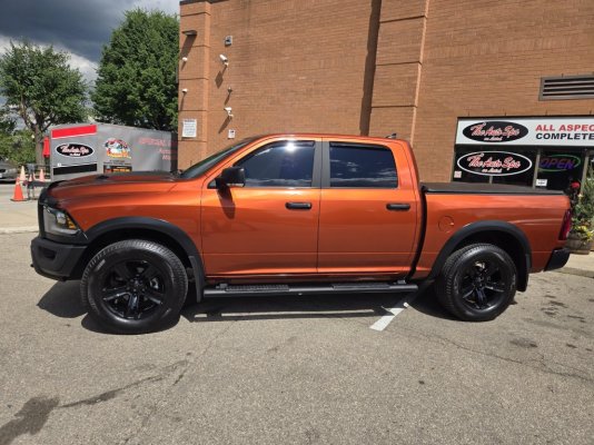

I currently roll on 20x9 stock Warlock rims with LT295/65R20's (equivalent to 35's) for my summer set up with no issues.
However, I do have 5100 Bilstein's all around on the stock springs with the fronts set to 2.1" raised.
You'll likely need raise the front a bit for better fitment, and clearance.

My experience
