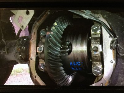

2019 and up 25-3500 have a standard plate type LSD. The Torsten was 2018 and earlier.4256F59C-FC52-4795-A5E3-B98541135888.jpeg

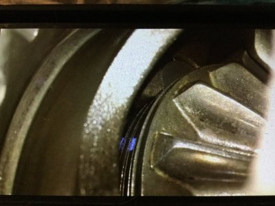

B5BCCE9D-7A08-43C8-9D05-979582CE7D96.jpeg Plate/clutch LSD. It works. If you want a true locker you’ll be putting it in yourself or paying someone else.

Well, that’s interesting information that’s new to me. A little reading indicates that starting in 2019 there’s a new 12” rear axle in use for diesel 3500 with the heavy tow package. That’s apparently the one pictured above.
I surmise the lighter duty 2500 and 3500 still use the 11.5”, which may or may not still be helical. Need someone who has one and has opened it up to chime in with the facts.

No. What’s pictured is my SRW 2019 3500 with the 11.5 rear at about 12000kms. There all plate/clutch type now, gas or diesel 11.5 or 12, except the power wagon.

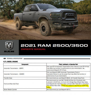

Does the rear now require a friction modifier added to the gear oil? That would be the biggest indicator it’s clutch type.
Edit: I just checked manual and it does state a limited slip additive is required for limited slip axles.
