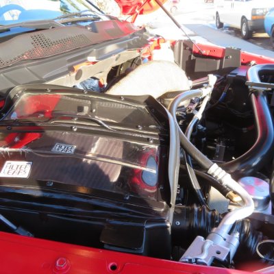

Your call,but i'd swap back to the original box,as you're not gaining anything with your hot air Air Raid box,except issues,the stock box actually is a cold air intake,while your Air Raid box isn't,it's a hot air box,as they don't seal worth a crap to the hood. Take a clean white rag and run it around inside the intake tube and see how clean it comes out.
BTW your 5.7 doesn't have a MAF sensor,it has a IAT sensor in the intake tube,and a MAP sensor on the back of the intake manifold.
I'd use Throttle Body cleaner instead of steel wool the next time you clean your throttle body,steel wool is a bit hard on the coating on the inside of the throttle body
Build a lid for your Air Raid box that seals the top,so it draws air from the fender.I'd also spring for a Filter Wears sock for the filter to keep the intake dusting down.
