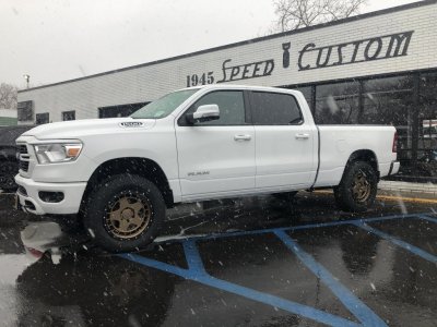

9DA5BA42-F58E-4AB5-9382-16748DBEA8BD.jpeg FA9AA2EB-1164-4D3A-9CB5-639111F8BF01.jpeg 2D93EA67-8FCB-44AD-B48C-8C6EF5D0C845.jpeg 3B620E2E-71D7-4953-B557-FDFAD7681DE9.jpeg My truck had 3” of rake so I got some 3” spacers for the front and installed them in a couple hours. Definitely helps to have another set of hands I got some fifteen52 Turbomac HD 20x9 +18 and some Nankang Conqueror AT-5, 275/65R20 tires 34x11ish which I’m totally happy with

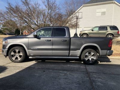

Here’s the RC 2” level kit w/UCAs on a 2WD, before and after. Actual lift on the front was about 1 3/4”. It’s still not quite level but looks much better IMHO.
2019 Laramie 2WD, 5.7 Hemi
Yea its good to keep a little bit of rake imo.
Truck looks great!

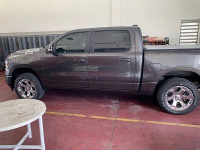

I did the install today - It did lift it. Like mentioned I don't think it lifted it a whole lot, but it does look better in my opinion. I got about 1.5" of lift out of it on the max setting. I was at 36" in the front from ground to top of wheel well prior and am now at 38". My rear is at 38.5" so half inch difference isn't bad. Pictures aren't great. Definitely looks better though overall.

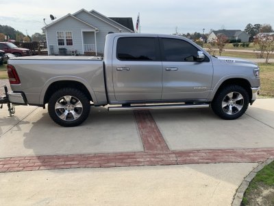

Mopar 2" Leveling Kit. Stock Laramie Sport wheels with 296/60/20 Nitto Ridge Grapplers. PS... The 295/65/20 were too tall.
