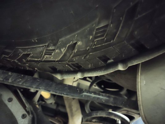

Just curious if anyone has tried to mount a 35" tire under the bed of a 19 power wagon. I put 35s on my truck and want to replace the factory 33 it came with.

While they definitely will fit in most cases and have been done many times, i would not call the fit “fine”. Most have to let all the air out of the tire and really massage it into place.

I went with 35's . I put a 315/70/17 in the Spare well. It's fully aired. It needed to be Massaged up there as well. But it fit easier than a true 35" Tire. It was less than 1/2" difference of my 35/12.50/17" Goodyear UltraTerrains. Which are supposed to be a True 35" Tires. I figure if I ever needed it. My 35's would be Worn down enough to make it a very close fit. I wouldn't be afraid "Differential wise" to run it. Until I Repaired the Tire, or replaced them. IMHO:Worse case. It would be no different than having a Brand new 35 as a spare and putting it on the same axle as the worn 35" Tire on the other side.

I finally got mine back up in there but it took way longer than it should have and 2 extra guys helping...
Wish i would have just left it stock...

I'm a newby here and bought my first Power Wagon yesterday (2019 2500). It came with 37" so I can assume they are not gonna fit? The current spare is a standard 285 70 R17.

A 35” tire is the latgest…which typically need to be aired down some to fight up in there.

ya i tried every which way from sunday to get a 35x12.5x18 aired up maxxis in there. not even close

Out of curiosity, what maxxis tires? Ive never had a set of them, but i bet they are more true to size than most brands.
