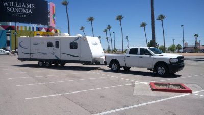

You would be supervised at how many people with 4th gen gas HD trucks re geared to accommodate towing. I had a 14 6.4 mega 2500, I was close to re gearing as the gear spacing drove me nuts, but ended up trading the truck. When I go hd again it will be a 8speed truck. It’s not so much the mileage but the overall drivability of the truck. The 6 speed will will jump way up in gears at low speeds and lug around town “ yes you can use tow haul and the gear selector to combat this”. I’m not one to leave tires stock so 35”s or 37”s are in the forecast, and with that the stock 3:73”s left me wanting more.. best to go drive them both back to back.
