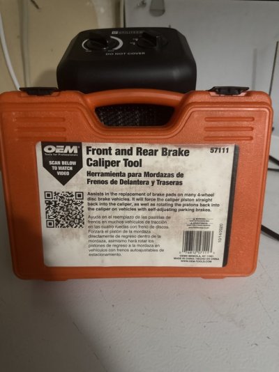

TRK_GANG74
Navy Badge
May 11, 2022
473
841
Va, Hampton Roads Area
So thanks for the info and the exactly what I did with the front brakes. But for some reason I can’t get the back to go all the way in. Do you know if the back calipers need to be pushed and turned at the same time?
The rear calipers have to be turned to retract them. You can rent a caliper retract tool from a auto parts store. I have my own like this.
