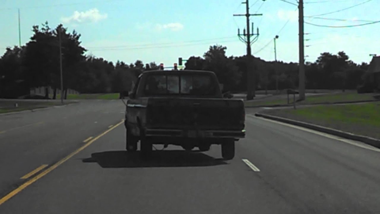

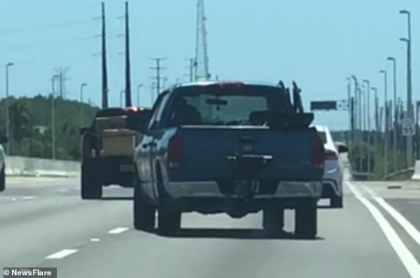

Have you ever driven behind a car or pickup that is crab walking down the road, you know that is was in a wreck & fixed incorrectly

I meant that this was bad for tires, this is an extreme sample
I have seen this too often :)
