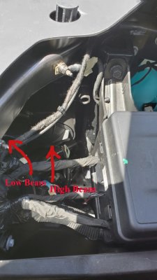

Step 1
Open your hood to locate the headlight low beam and High beam covers on the back of the headlight. You will see the high beam is very easy to get to in order to change out the bulbs. However the low beam is under the fender you can access from the top but is a lot easier to remove a few screws from the fender liner.

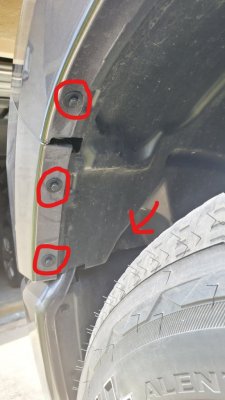

Step 2
Go under the wheel well to the fender panel. You will see there are 3 8mm Screws to undo and 1 push pin in the center of the fender liner. Than you will be able to pull back the plastic fender liner to get access to the low beam cover.

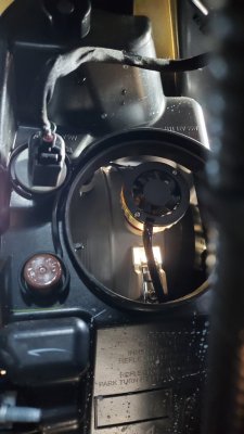

Step 3
Twist the cover off and unplug the low beam bulb. Then you can untwist the H11 bulb out.
Step 4
Put our led bulb in and twist it into the lock position. You want the led chips facing 3 and 9 o'clock. Push the black driver inside the headlight and put the cover back on.

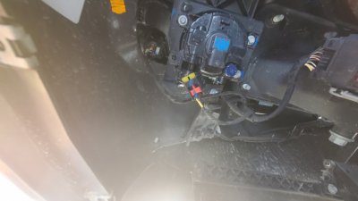

Step 6
below the 3 screws you removed for the upper fender liner plastic, you will see 2 more screws. Remove those and pull back the lower fender plastic piece to get access to the fogs.
Step 7
Unplug the fog light bulb by pushing the red tab down and press and pull down and twist the bulb out.
Step 8
Twist our led bulb in and plug it to the oem plug.
