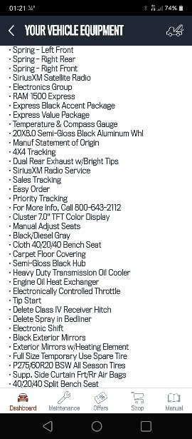

OK, I am a lil confused. WHY does the truck (a 2020) not already have a factory installed Class 3 hitch. MY 19 came with an Optional Class 4 Hitch factory installed. I have not seen ne trucks in a while not having a factory hitch, hmmmmmmm.
My truck didn't have a receiver when I bought it. It has it listed on the build sheet but has the words "delete" next to it along with the bed liner. I'm guessing the dealership ordered it without it hoping that the future owner would pay to have them install it. My truck has a 3.92 rear so it's a towing truck and that's what I use it for. But I didn't buy it off them. I bought it and installed it myself.
Sent from my LG-V60 using Tapatalk.
OK, kinda amazing, but OK... I's just a BOIRD, but why would FCA even offer a truck w/o at least a class III Hitch, hmmmm, more ways to make $$$$ I guess.
