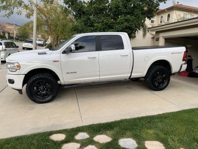

Here is my buddy’s 2020. 35s on stock 20s. No lift, no level. 100% stock suspension. No rubbing either.

No air suspension. I don’t know on a 1500. I’m assuming it’ll work, like you said with minimal rub with factory wheels or factory offset wheels.
my 2500 has a 2inch level with 35s. My wheels are 0 offset and I have alittle rubbing, had to trim. My buddy like I mentioned is stock suspension, factory 20s with 35s with no rubbing whatsoever.
