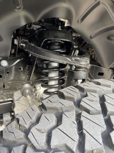

35s on 22x12 -51 offset.. I got it aligned still rubs pretty bad. I trimmed the fender liner but like I said I hate cutting plastic off my truck I think it looks like ****. I think I would be able to add a spacer in the front. It would be no different then someone adding bilsteins on a 6inch lift with them cranked up all the way right? The only bad would probably be it would ride stiffer cause it rides like a Cadillac now lol313EAED6-17CC-4826-8DD6-AF85FF1BA98E.jpeg

It is not the same as adding billsteins to a spacer lift. The concept is the same but the geometry is completely different. Your better off running a full length coil over and dialing it in.

Post a pic of where it rubs I want to see how close or far it is

I would not add a spacer, but thats me. One thing to do, is use a floor jack and lift the front up two inches, then turn the wheel lock to lock and see if it even helps…with those wide *** wheels im sure it will still rub anyway.
My opinion is either cut/trim as need or put different wheels on there. The tires already look small to me, cant imagine lifting it more.

I’ll grab a pic of where it rubs tomorrow. By the way it sounds I’m not gonna be able to change much and are just gonna have to start cutting

Yea I jacked it up and it doesn’t rub but I guess I’ll come up with something

Cutting is not always needed there are a few tricks to pull the liners back. Keep in mind it’s a brand new truck

So I did the math a little bit considering I don’t touch rough country I looked up their kit. Since you have the full length struts you will be able to get away with the ready lift kit part# 66-1921
Contact @Nick@GotExhaust to set you up with this kit. You’ll also want to redo the rear lift. I would recommend having nick set you up with the zone 5” rear box kit. The relocation brackets are better than rough country and you’ll get a full coil spring and proper rear lift. Nick will know exactly what I’m talking about and you will have a better riding truck with tires that don’t rub

RC kits are not ideal, replacing as much of it as we can is a good call. RL kit is in stock and I would just have to check when I get in the office on the rear box kit but we usually have them in stock as well.
