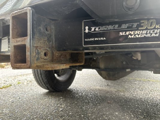

Curious if anyone has any experience with TorkLift Magnum double hitch rusting out, about 3 years old. Are there ways to repair or protect the underside of my truck from rusting in the pacific northwest?

Best --> Sandblast - prime - paint with bed liner. $100-150 and a few hours.
Easier --> Spray paint
Easiest --> Ignore it.
Certainly more rust than you'd hope after only a couple years but its mostly visual.
