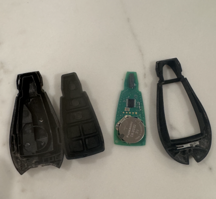

Thanks again for all the help. I think the window sticker told us everything we needed to know, but I took some pictures.

So like i suspected, you have the contacts in the FOB ( it is the right on on the first set of two)
I would "push" it and see what happens
But as I mentioned, last time I had a diesel, I had to watch the voltage gauge to know when the plugs were done drawing power so I could start it...so I'm not the most up to date

Update: I took the key apart - pushing that button doesn’t do anything visually (no lights flash) and definitely doesn’t start. Didn’t see a hood switch but I think I was looking in the wrong spot. I’ll need to check again when I get home. Sounds like I need to check out the hub behind the backseat as well.

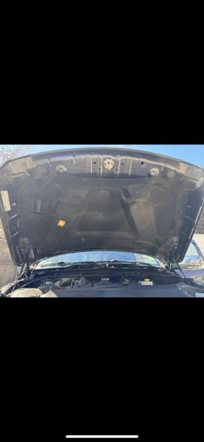

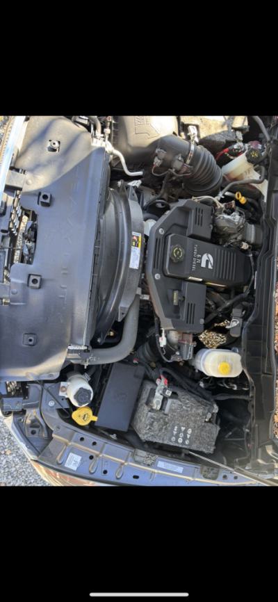

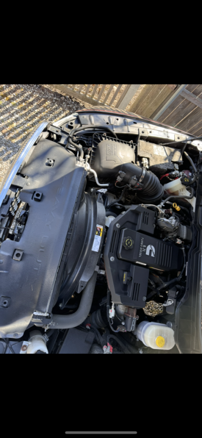

I don’t think I have the hood switch. I took a couple pictures, but I didn’t see anything.

I don't know if you have sorted this out but it sounds like you could just enable it in alfaobd and reset the RF Hub, your truck is newer then a 2017? the consensus is all newer trucks use the same rf hub. My 2016 does not I looked into doing that you might have the hood latch sensor, does your hood up indicate on the dash? if not you could just ground the pin and change the setting in the bcm all that being said I am curious what you found

Considering this is quite old now you either figured it out or you moved on. I figured it out on my truck. my remote start is working perfectly, it took some wire I already had on hand, some connectors I ended up ordering and a crimp tool I ordered but my remote start works perfectly. I will need the hood latch with hood ajar sensor but that will only be to make sure the safety is in place later. So to "paint" the picture. my truck had the wiring from the bcm to the connector under the fuse panel. I needed 2 wires installed in the female side of the connector and run that out to the hood latch area, there I spliced them so they go direct ground. I will change the latch so then one will connect to one pin of the latch the other to the other.
