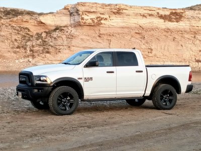

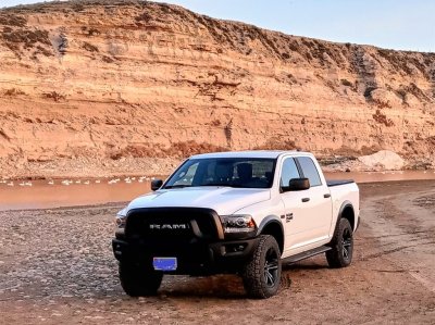

Been a while guys, but, thought some of you could use the info. I had a hard time figuring out how to level this truck.
Just lifted my 2021 Warlock 4x4 with the Eibach Pro strut and matching rear shocks, with the factory springs. I initially installed the front strut with the middle setting. The Eibach strut has 5 settings. I was shocked after putting the truck on the ground, because I ended up with only .5 inches of lift. 2nd time around, I set the Eibach at the top setting, which is 2.8 inches, and it gave me 2 inches over stock. So, yes, I lost the .8 inches due to the factory 1 inch lift. This made the front of the truck leveled with the rear, at 40 inches to the fenders on all 4 corners. I added a 1 inch spacer to the rear, however, it gave me closer to 1.5 inches. I wanted some rake and am satisfied at this point. I installed Rough Country UCA's for the Ram 1500 with 3 inches of lift. The shop had no problems with the alignment and the truck is tracking true. I've put a few hundred miles on it and am happy so far. Less floating and a more planted feel. Everything fits and clears. The picture was taken after going down 40 miles of dirt road, getting to the river, to do some fishing. Handled the bumps nice and did pretty good on the washboards. Nothing to crazy. Speeds in the 40's to 50's. Corners better now, also. Will probably upgrade again down the road, but, am happy for now and pleased with the new stance.2021 Mile Lifted (3).jpg
Upgrades so far---Eibach pro strut set to max(add 2 inches of lift to the Warlock). Eibach pro rear shocks with 1 inch spacer. Rough Country 3inch Upper control arms. Go Rhino D6 Dominator running boards. Toyo AT III 275/65/20 E-rated 43psi on factory 20x9 wheels. Bed cover.

Truck looks great. I have the same truck, what do your CV angles look like? Having an issues since you've installed the eibach kit?
