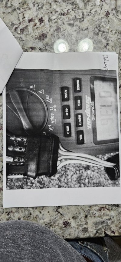

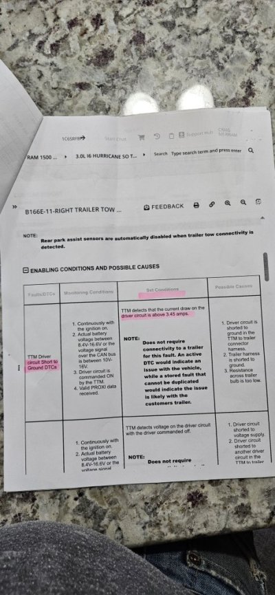

So here is the report they gave me. I don't know how the truck can distinguish left or right tow lamp circuitry if the tail/ running lights power supply is only 1 wire that is either on or off. It's independent of the turn and brake lights.
