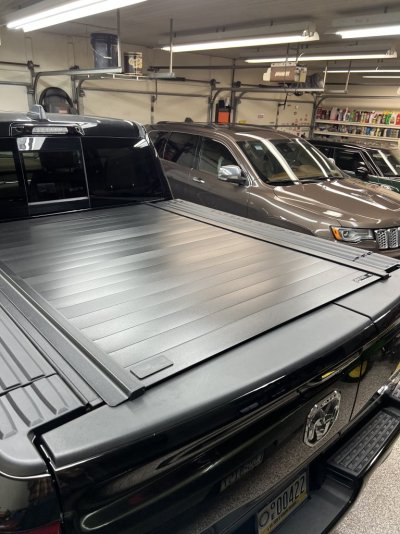

Here’s a pic of my Retrax Power Pro MX cover on my ‘22 Longhorn 1500 for reference. Silver rails are a must and to sell your OEM cover, the buyer would need those black rails.

Wow, that looks great.

Birdie Boy, yeah, you definitely don’t need the power cover, the one thing you get with it though, is a bed light. Not really a big thing now with most trucks already have bed lights. Save about $800 (?) or more too.
