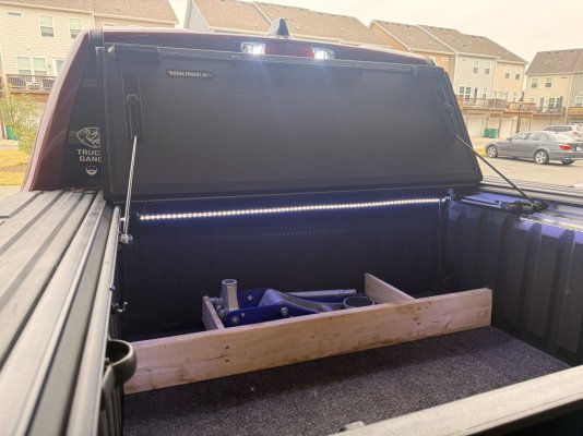

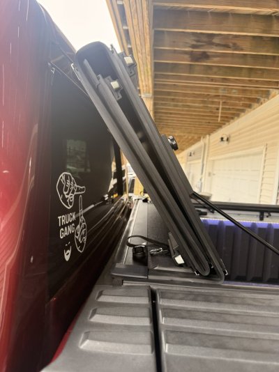

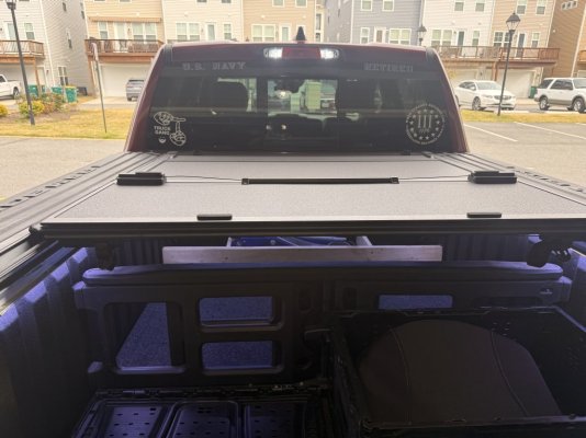

TRK_GANG74
Navy Badge
May 11, 2022
471
836
Va, Hampton Roads Area
MX4 Bak Flip with Silver Cargo Rails and Ramboxes. 19 Laramie Longhorn 5.7 Bed.
