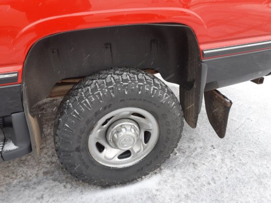

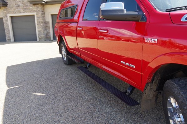

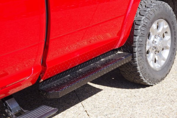

There is an option to disable the power running boards, my 2021 has it in the setting menu. You might try ticking that check box. I have Weathertec mudflaps, and rear box boards that go all the way to the body, and I still get a lot of crap on the sides of the truck running in mud.
If you double click on the pictures you can zoom in on them.

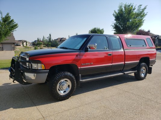

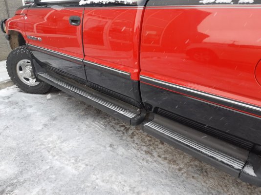

The current factory running boards are no where near as effective as the ones I had on my 1996. These did a much better job of keeping crap and rocks off the PU. This has 280,000 lklms, about 75% not on pavement, and that is the factory paint.
