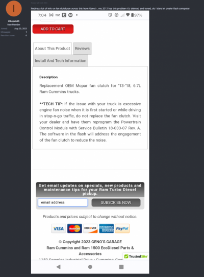

Just got this from a guy with the same issue.....
Has anyone here tried this? I am days from getting rid of my truck due to the excessive fan usage. I have similar/same problem as everyone above. It's now between 50 and 80 degrees here in AZ. My fan DID used to come on at initial start and shut off EVERY time once I hit 40mph, regardless of in town driving or not it never ran like it does now. Now, at 50Degrees at 4am in the morning driving to work the fan will run all the way up to 95-100mph and not disengage!! to be clear, I NEVER drive that fast, but this fan/fan clutch has pushed me to test at what speed, temperature or anything that will get it to disengage. Sometimes, it shuts off after 15-20 minutes of driving, other times the fan is on for 40+ minutes straight. again, at 50 degrees the truck should be purring like a kitten . . .
would a dirty air filter cause this? **truck never over heats but willing to try everything .. .
I don't know if I have AGS, how can I find it and what do they look like?
