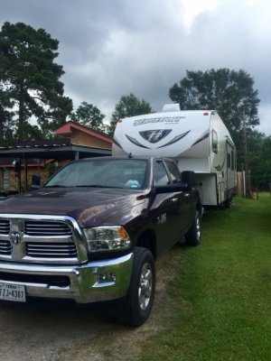

Feb 3, 2015
70
2010
Just made my first long distance trip last weekend, east Texas hills with cruise on 65 was no issue for the ctd....averaged 13mpg too
Tow/haul and the e-brake really helps reduce wear and tear on the brakes
With all that said, look at the pin weight then determine if you need a 2500 or 3500, I have a little bit of bucking so I'm adding air bags in the near future
