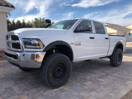

silvrzuki77
Oct 1, 2018
32
23
Las Vegas
6.7
2.75” lift from Thuren and 37’s on 18s. No rubbing.
