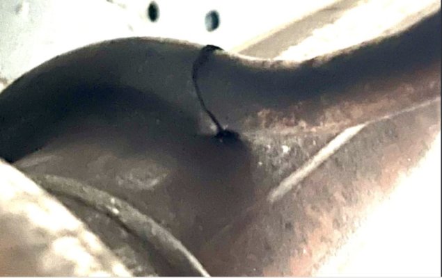

hi, I have a 2023 Ram 2500 power wagon hemi 6.4 and I started to hear a little rattle at low RPM during the gear changes. During the muffler delete process I notice some rattling from the cat, it feels something is loose inside the cat and when I tap it the sound seems to be same I hear from the cabin. My truck has 40k miles only, any idea if this is know issue for hemi 6.4 cat? loose or break internal components causing noise when the exhaust vibrates?

On my 2020 there is a tie between the two exhaust pipes in front of the cats and it was cracked. I welded it up and it hasn’t rattled since.
I’m not taking a picture of the fix as it’s hard to get in there to weld it and it’s not internet worthy.
good idea. I checked the cat support but don’t recall checking this specific part. Will check again
Just checked my truck, you nailed it!!
I have the same crack in the tie between the two pipes. I’ll find a good welder shop and have it fixed.
Thanks!!
