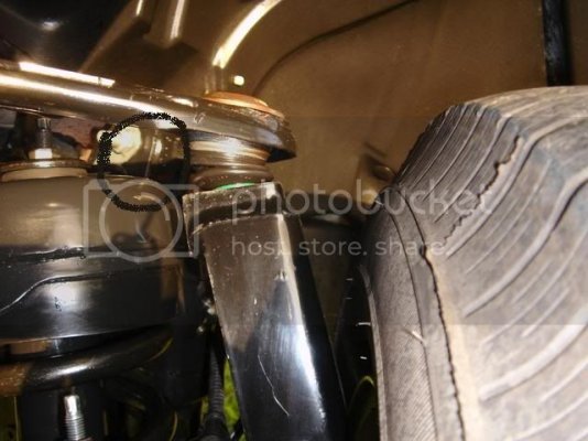

Just understand that if those shocks are longer in travel, the a-arm WILL hit the coil bucket, that is why they use the stock ones length, if your shocks are longer, jack it up off the ground look at the top of the coil bucket where the a -arm can hit it.....Justin,.... dont understand what you mean the shocks wont reach, my spacers on my CST 7 inch, are 2.5 inches and the stock shock length are on there perfect.... I have tried the 1.5 , 2 ", 2.5" and also the 3", spacers when I was lifting this one, back in 09

Try jacking it up and look at the a -arm to coil bucket clearence.

hmm, whats your concern? if anything hits? while driving? if anything hits while the shocks are compressed or extended while driving? im not too sure what you want me to check out

What i meant is full droop, like when the truck goes over a pothole while flying down the road, the wheel will follow the hole down and the upper control arm will drop down and so will the lower control arm, if something doesnt stop the travel ...(ie. the length of a stock shock) the upper control arm will hit the top of the coil bucket, before it it tops out, this is bad....I know if you put on shock that are just 1/4 inch longer ,you probably could get away with it, but if they were 2 inches longer they will hit, so if you jack up the front wheel off of the ground and look at the upper control arm , does it touch the top of the coil bucket?, and like I said before, unless the 2012 has a completly different control arm and coil bucket than the 09/10, the info is correct.
just trying to help
here is mine off of the ground and here is the clearence with 2.5 spacers and stock shocks, if the shock was longer the control arm would hit, can you see the mark at the bottom of the circle, left when the shock was removed and it was sitting on the coil bucket , before I put them back on?

dang, i gotta check that out, i have hit a couple pot holes since, but haven't really heard or felt anything, i gotta check into that.
