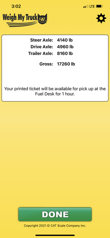

I have a 2018 with 4.10's and towed a 2021 Grand Design Imagine 3250BH about 100 miles home from the dealer for my step-son (he had a Tundra). Pretty flat roads but the trailer weighed 9300lbs (CAT scale verified). Truck towed it great and I got 6.7 MPG hand calculated. EVIC read 7.4. My son had an identical truck and towed his 2018 GD Imagine 2670MK that weighed 8100lbs CAT scale verified. He towed it all over the country but on his trip from Pittsburgh to Baytown, TX I went with him and over 4 tanks he averaged about 8.0-8.5 hand calculated.
This was with the 3250BH on the truck with 3 adult males (about 650-700lbs between the 3 of us).
The truck alone with us 3 was just over 8000lbs. We had 1100lbs of tongue weight
