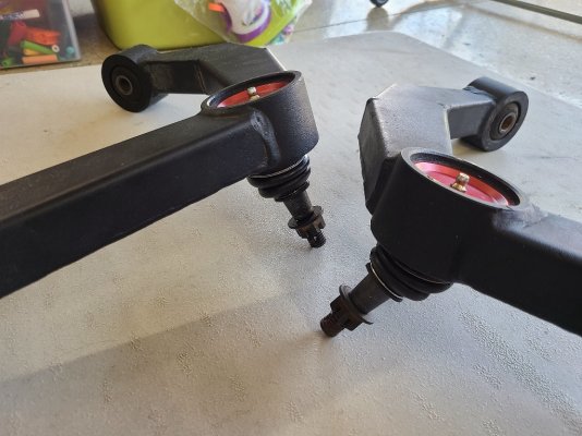

I have a set of used Zone UCA's in the 4 sale section. Much better than RC uca's. $250 shipped.

Thanks, I'll definitely consider these as an option. Are the castle nuts for the ball joints included? I don't see them pictured and I'm not sure if the Zone ball joints use the same thread pitch and diameter as the OEM nuts?

Yep they're, i also updated that pic. you'll need new cotter pins though. You can get them at Lowes, Home Depot etc etc.

Factory upper ball joints would not have lasted long with these spacers. I didn't get photos of the stock UCAs as I was in a rush to finish installing everything before a road trip but the stock upper control arms were nearly touching the strut coils at full droop. I'm glad @ram1500rsm convinced me to buy his Zone UCAs. At rest they are perfectly flat and the truck aligned well with them.

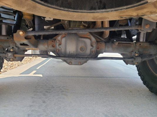

The rear 3'' spacers definitely have the panhard at a gnarly angle pulling the axle toward the passenger side more than I prefer. Once I figure out which Core4x4 control arms and panhard to order (and if they work with Zone/BDS relocation brackets) this should be resolved. Gotta do some rust removal as well. :)
