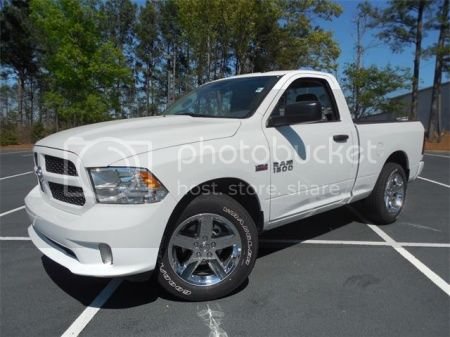

Barely a week after getting the truck it's leveled. 3" billet aluminum spacers
Love the new stance. No more "cat in heat" look
Once I wear out the good-for-a-years I'll get some 275/65/20 nitto dura grapplers
Before
After

hows the ride? when are you putting in UCAs?

Not going to change UCA's? Arent you afraid of the ball joint issue rearing its head on ya?

Looks good. I have a 14 RCSB as well. Did you change the shocks or use extensions? I had a 2" spacer on my 09 2wd CC and after a few weeks I got a set of pro comp es9000 0-3" shocks and it rode a lot better than the stock units. I am also curious to see how the stock uca's hold up.

Where did you get the 3" billet spacers from?

I`m also curious if your ball joints are gonna hold up.
I went with just the 2 inch for that reason.

Turns out the 3" was too much. Upper A-arm was hitting coil bucket. Swapped over to the 2" kit. Sits dead level. Added 2500 stock shocks and rides like stock.
