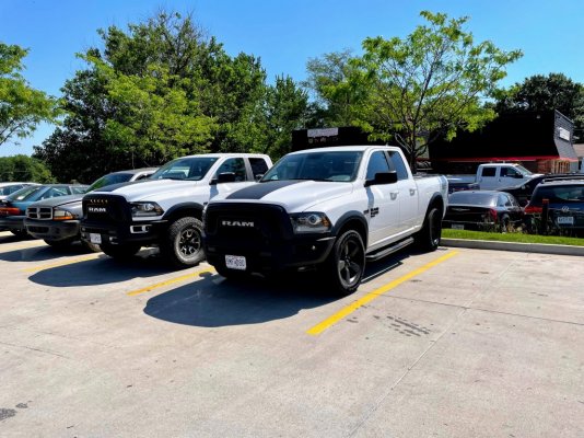

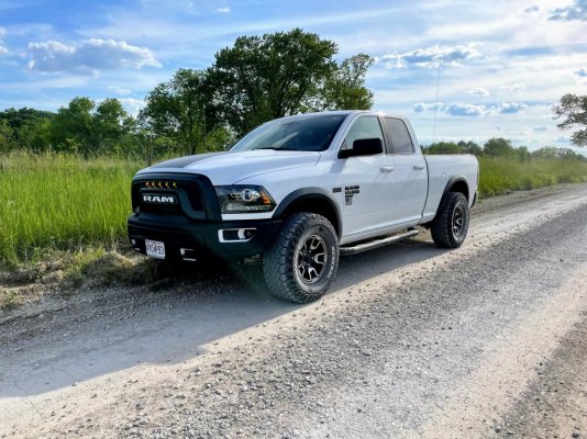

You will be absolutely fine with just the bils swapped in! They have the needed bumpstop already. Set them at 2.8 and you'll be riding perfect.
Here's mine set at 2.8 with 315/70R17 (35") tires next to a stock one
and by itself
I have had 0 issues with anything binding or catching in the 40,000 miles I've had my 5100's at 2.8
